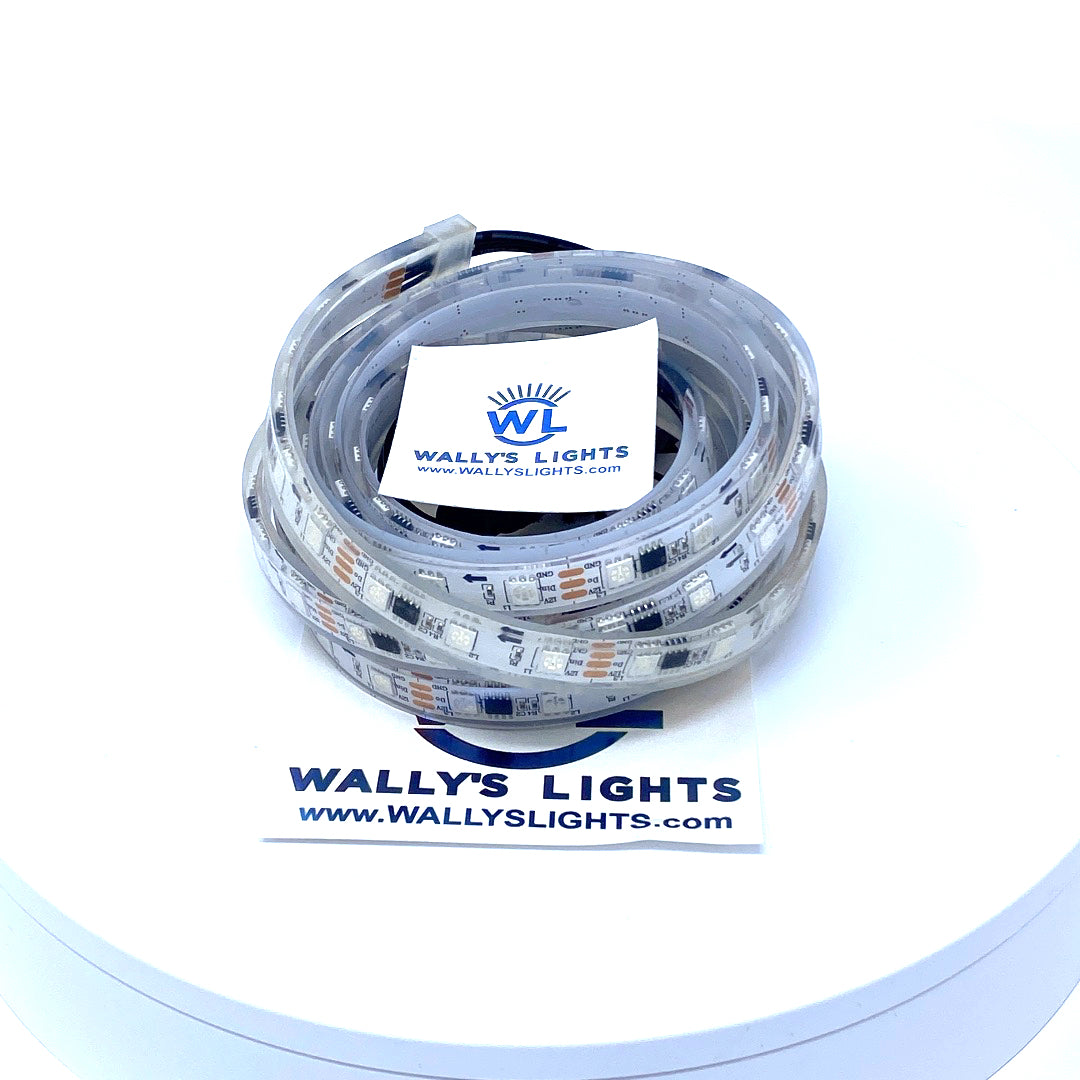

I kept having the hardest time with strips I cut and soldered pigtails onto. This year I moved to pre finished strips from Wally's Lights just to get a factory end on both sides. last year I made 4 arches and 2 had the same exact problem by the time they were put out.
You know I've seen that 3d model before but i ended up printing a different one which didn't work for mine, and i feel I'm in the same situation as you were, after cutting and soldering everything, once i put them out two out of the four arches lit up, i then had to twist and pull one end to make it work temporarily, i looked into the strips you are talking about and looks like a good idea to keep from messing with these strips every year, how do you like them? I really like the whole DIY but if this is going to be happening every year then i rather just get those strips if that's going to save me problems down the road.

Well, I liked the model it kept things strait and worked how I needed it to work. In the long run I went searching for an led strip that was pre-made and found it at Wally's Lights. They come factory just slightly longer but still fit in with my old materials so I remade 2 of my failed arches with the new strips. They worked perfectly even though the pex tubing could have been a little longer.
