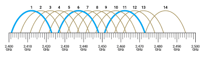

5GHZ has no overlapping channels (at 20MHz). Meaning each channel can be used independently.
Contra to this, 2.4GHz has 11 available channels in most parts of the world, but they are only 5MHz wide channels. Which means that there only 3 that don't clobber each other, being 1, 6 and 11. If others are using anything in-between, they will appear as strong interference.
For both - two Access points on the same channel are not a bad thing, they can hear each other and co-ordinate transmissions. It does lower bandwidth however.

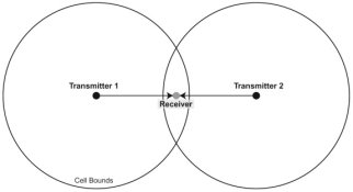

There is also an issue called "hidden node" - whereby two transmitters cannot hear each other as they are on opposite sides of the AP. See diagram below. They both send at the same time, and the AP gets confused, and things need to be retried.
My opinion in this matter is that you should put your AP in the corner of the yard, and have all devices on the one side of the AP. That way, if they can see the AP, they can see all other devices.
