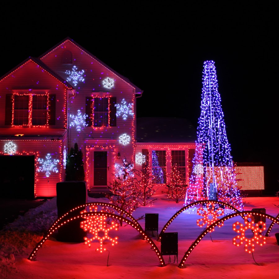

Hi All,
It's my first year of pixel Christmas lighting this year, however I have been working as an entertainment lighting technician for 10+ years ranging from arena/stadium tours as an operator, too larger theatrical productions. However, grandMA2 and disguise media server knowledge is leaving me rather stumped in this realm.
I've attached a screenshot of what I want to achieve this year via pixels. Whilst I understand a 4.5m 48 strand 3D Megatree is a big undertaking in the first year, with the knowledge I have and some like minded industry mates I believe its achievable.House final Drawn.PNG
Please note, I haven't measured out all of the arches and house outline yet, so those pixel numbers are all over the shop - planning on doing 50mm spacing all around.
The stars I haven't picked the exact model yet, so haven't built all the sudmodels.
Here are my main questions.
What would be the best way to control these pixels allowing for further expansion as well?
I plan on making this display significantly larger in the coming years, as i am also integrating moving lights and other lighting elements and using it as part of my portfolio.
I've been looking at Advatek vs Falcon debates everywhere. My initial idea was to go with a V3 with two expansion boards for the mega tree and running all 48 strings individually.
I know this isn't "efficient" but it seems like a really clean way of doing things for the sake of one extra expansion board.
Plus running the 48 and sending receiver boards all over the yard and roof.
Pricing all this up with Falcon seems to be around 1500 usd. I would ideally like to keep that purchase in Australia, but I didn't understand Advatek/Hansons boards as well and struggled to piece together how i'd run the system.

Hello and Welcome @Ambarta !
Good to see you have a background in theatre/concert lighting. I've never done pixels with the Chamsys console I use. Mostly because I don't have a media server to do so. But I have heard around that xLights supposedly can take execution commands from lighting consoles and then send the bulk data to the controllers.
Last year was my first year even using a digital lighting console, it's a pain trying to work out the Chamsys menus! Give me a GrandMA!
My display (for my first year) is a Falcon F48 and xLights. The show file is on a Raspberry Pi single board computer which outputs to the F48.
xLights is really were it's at. Falcons and xLights go hand and hand. Just create your display setup in xLights and it uploads output definitions to the controller. The F16v3 and F48 can both handle 16,000 pixels. That is a big display for your first year!
Using another sequencer just means you need to tell the pixel controller what channels go to which port.
LightShow Pro and any other software can be used if you're knowledgeable.
As a note (you've probably figured it out already...): Most people use 510 channels as a universe. Because it's divisible by 3 for 3 channel pixels.
