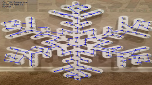

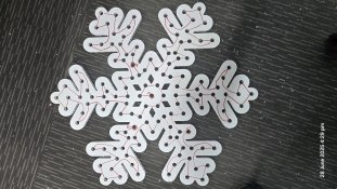

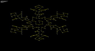

So mine is a first edition version here is the layout for wiring for the flake A
the wiring doagrm its hard to see where 12 -15 go exactly, but if you look on my drawing and the lightshowhub model ( from the front not back) you can see the physical location of the next pixel clearer then the wiring diagram

Looks like the issue in the thread is solved, but for anyone else coming along (with the problem I expected based on the title), there are in fact two editions of the GE Flake A. You can tell them apart quickly by looking for the presence or absence of the center node. The center node is an older one, the empty center (allowing a nice round 150 nodes) is the new edition.
