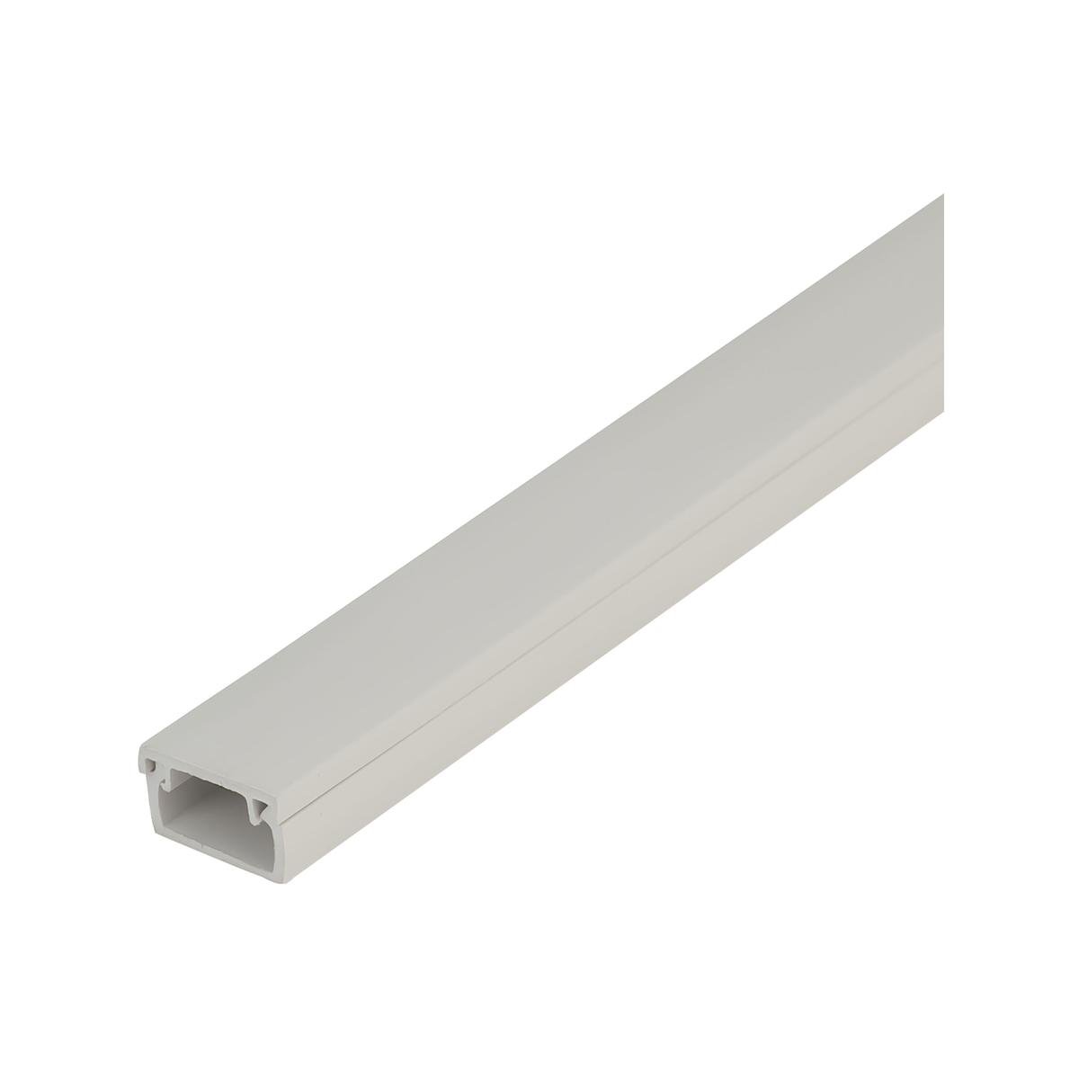

This seems like a job you could knock off in a weekend with limited skill, some trunking, lights, power supply and a controller.
I installed on my eves with 16x10 Trunking from Bunnings, drilled holes in the side and pushed the leds through this, run my power injection wire through there also and clipped it all back together to provide a nice and neat finished product. I then glued some strong magnets inside to allow it to attach with magnets and was made to be easy to put up and take down but i ended up just leaving them up all year round.
Yep, just standard 5v WS2811 Pixels, I made a jig and drilled the side of the trunking and also had space to run a power injection wire through there also.
