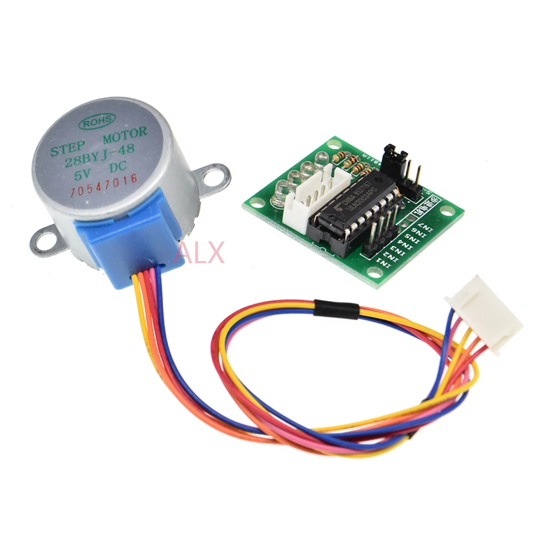

I have been playing around with some designs, Jarrad was kind enough to let me borrow his Hurricane as it had a different process on the bubble wand compared to the cheaper units most people pick up which seemed to allow for the protenital for better control/less wastage in possibly a smaller footprint.
On that end, I have ordered some motors/blowers/pumps and drawn up this basic design to do a trail on to see if its a feasible design to move forward with.
View: https://drive.google.com/file/d/1-YrJvoakIDVGdUX3nopfO29MV9Wd3aw_/view?usp=sharing
The Design should be able to fit into a footprint something like this, which is a 120(W)x150(L)x100(H)
View: https://drive.google.com/file/d/1-wo7FgzTcu1jRIjjdI5wDVHS3jEC64xP/view?usp=sharing
View: https://drive.google.com/file/d/1-zIum2uXDAu7X-qdYuzoZgJMYit_HLUx/view?usp=sharing
View: https://drive.google.com/file/d/1-zvHWb6czRdq16lw14e_s6ftG40iZSc7/view?usp=sharing
View: https://drive.google.com/file/d/1-nj0w9GQ9s3D8LUnMMkMmdKTicv_X_th/view?usp=sharing
All of he components i've orderd so far are 5vdc units so if they all end up being suitable the build may be able to be run off usb level power.
I need to order some HDPE to do some test cuts and work out controllers etc but for now I should just be able to power everything up to test.
