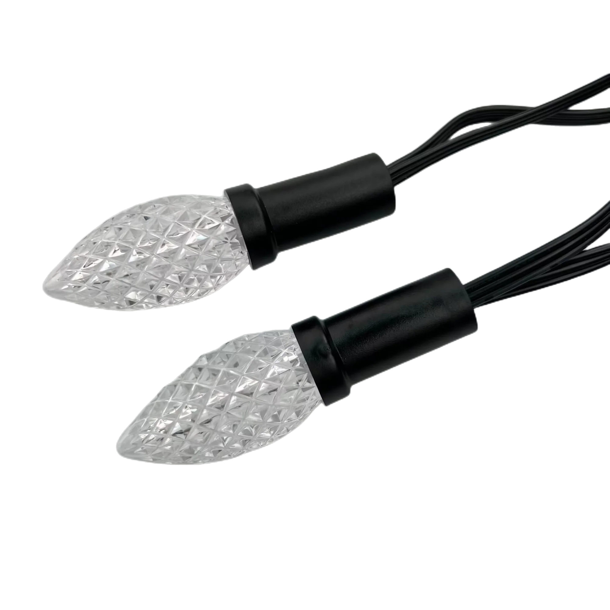

I wanted to put lights on our roof ridges this year so I have bought 4 x sets of these:

I have 4 sets of 50 node string lights (200 total). I am not sure if I will need all 200 to be connected, im thinking I will only need to connect 3 (150 total)
