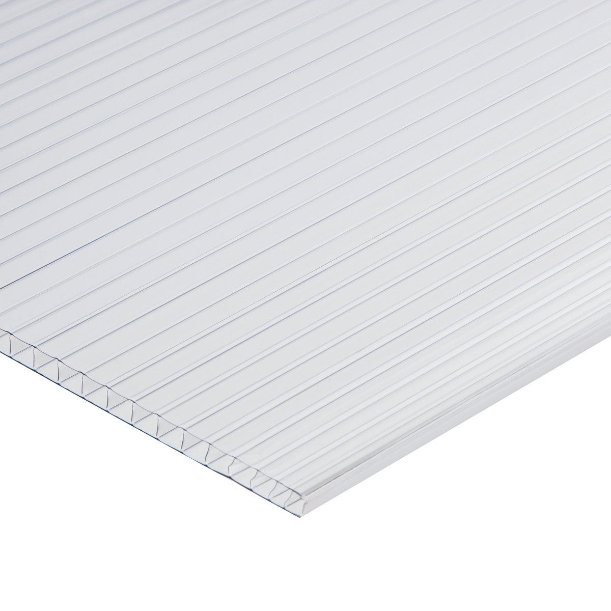

Back on topic though, along the lines of your coreflute idea there is also the transparent sunlite transparent panels:
Someone did a matrix from these… you might be able to find the thread. I think it may look better than white Coro…. their videos looked great.
This one was white coro. I was looking at using the Sunlite panels on my Solar matrix as they are clear.
@Nojoy mentioned he tried the sunlite panels; and there is a video in there of someone else who has done it.
Thanks @Skymaster, this is what I was looking for re: the White coro option.
