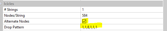

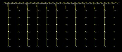

Thanks mate. I will modify the model in xlights to match what I have. Appreciate the helpMost icicles you need to put in the drop pattern you have.
I got some from ELD at this is what I use. Make sure you click alternate nodes
might be slightly different depending on what you ordered
