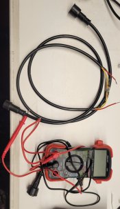

Like I said, I never got a fuse to blow by just adding pixels (don't ask how I did do it). 12V regulators on full white very close to the controller do get right up to 5A (which may or may not be close to blowing a 5A fuse, see
View: https://www.youtube.com/watch?v=AUbmq6UJXgg
). How do I know? Well, this isn't exactly high precision, but I repurposed some pigtails and a cheap multimeter as pictured, to get a rough idea of the amps. Just put the 10A current setting to the red wires to complete the circuit. (Of course this is a crude method, because multimeter is slow and imprecise, the extra 3' of wire adds resistance, etc., but it is better than no data at all.)
