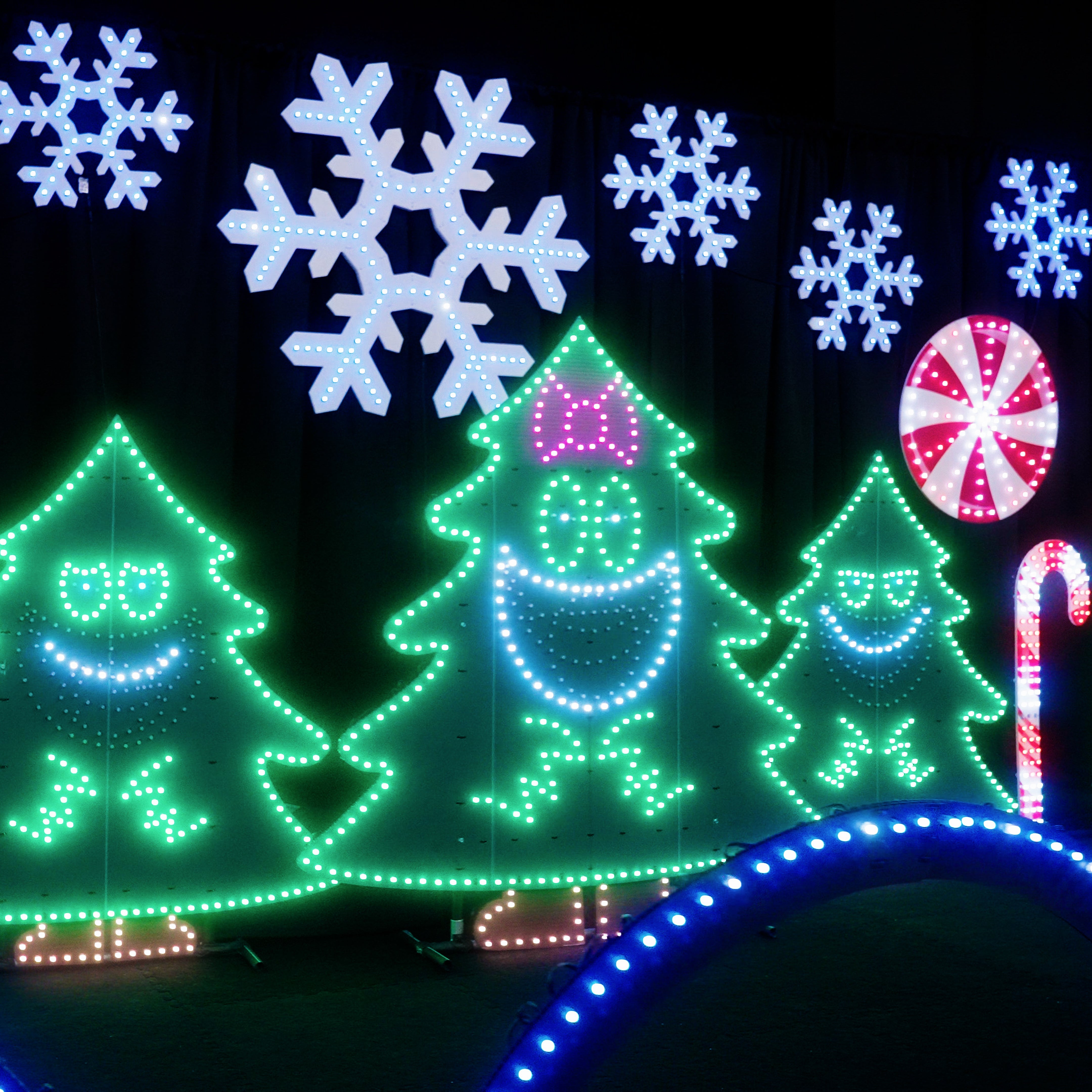

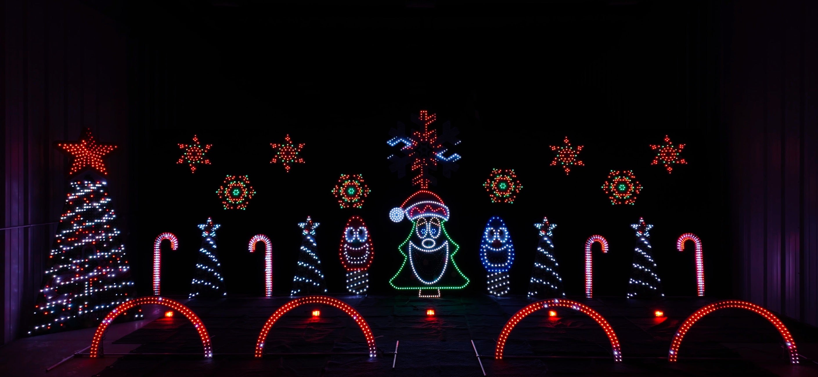

If you just want to setup a show some of these pre-built might be an option.
I loved my Mr. Christmas (circa 2010), then the display got too big in the mid-late 2010s and I took it out. Wanting the music back is how I ended up with the pixel mayhem I have now.
Anyway, if we're listing easy vendor solutions and you want to keep your existing AC lights from the Mr. Christmas (and maybe add some pixels too) then:
The MLS and Gilbert kits are interesting. (The obvious limitation of these kits is that they don't have house outlines, don't do whole house effects, etc., and the sequence selection is very limited / high price for what you get.) The good news on those kits is that most of what is in there is reusable if you get more sophisticated later... you can plug the props into a lot of other controllers, get xLights sequences, etc., and probably keep the controllers in the show too, as they look pretty standard.
If you want a bit more flexibility right away and don't want to put the time in, you can also look at EZRGB but their show designer seems to have taken a turn for the worse this month, hard to say if it'll be ready for mass market in a few months or not at all this year.
If you're not in a big hurry maybe check what the vendors are offering again in July, as Expo is when they really have their stuff really ready to sell (vs. preorder). (And except the stuff they rushed to market, skip whatever those things are and see about them next year.)
