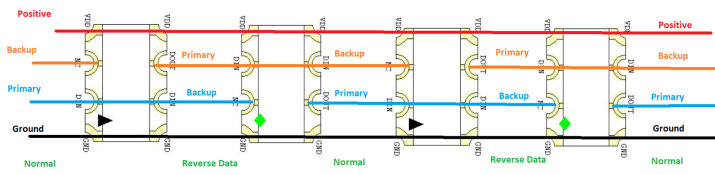

One more thing -- some seeds swap the Primary and backup data line every pair of seeds as part of the way they are wired. I'll try and find the diagram skymaster made for it. Just one thing to watch out for.

The issue with swapping the primary/secondary around -- if you connect the only incoming data into the secondary line - the seed thinks its a backup wire - so it silently drops the first pixel of data and starts displaying from pixel 2. Now if this is an outline - you're probably not going to notice. But if it's a singing face or some other detailed prop -- having everything off by 1 will be an issue.
Basically in order to facilitate them soldering onto a single 4 core flat wire, and not having to "Swap" wires, they do this. There is a seed of type "Green Diamond" and one of type "Black Triangle" according to the data sheets.
So on the black triangle one, they cut the second (orange) wire, and on the green diamon, they cut the third (blue) wire.
As you can see every second pixel the data is reversed.
How do you tell the difrerence - you dont, externally.
Feed in a signal which has the first pixel lit blue, and the second lit red, the third lit green.
If the pixel lights up blue, you have the signal feeding the primary data line. If it lights up red, you have the backup data line.
That assumes RGB pixels, if they are a different colour order you need to take that into account.
