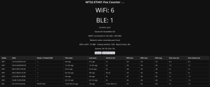

I built a visitor counter
SmartAlecLights
Im a SmartAlec what can i say!
Community project designer
May 4, 2010
1,629
Murray Bridge, S.A.
Ive been looking into them Pax Counters.
https://github.com/ThingPulse/esp32-gateway-paxcounter/
https://github.com/cyberman54/ESP32-Paxcounter
But I wanna use different hardware (Im want POE Counters)
So i choose the WT32-Eth01 module.
Argued with Claude AI for a couple of day's.
Ended up Producing this code to use in the Arduino IDE (Needs PubSub and NeoPixel)
https://smartaleclights.com.au/acl/wt32_paxcounter.ino
The POE Splitter handles the 48v down to 5v
Feel free to use it and edit it as you please
After Testing, I noticed that the 5G network wasn't being picked up.
So the next lots of parts i will be testing is the ESP32-C5 with the W5500 module.
pax-output.pngExample of MQTT output.
Someone could make a FPP plug-in for it as well!

I just built one of these with the Cyberman pax counter software. I ran it on a lilygo T PoE Pro board. I had to solder on an antenna socket and move the resistor that was smaller than an ants foot to another set of pads, but it works brilliant bringing data into Home assistant very well.
