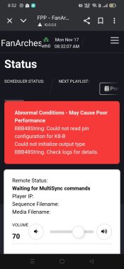

I have 2 Kulp K8-PB that i cannot get to output to lights, the Channel status lights don't even light up. Any help would be great
figured it out, firmware update did the trick thanks to this board and reading other posts
Is this what yours said??
