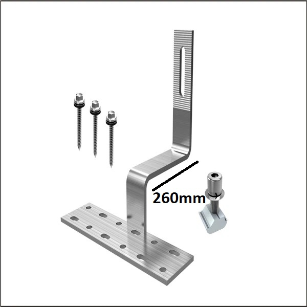

What sort of roof do you have (tiled, etc)? I have a couple of MH to play with and possibly use this year. I was considering using the brackets typically used for solar panel mounting rails, the build a platform off those. I've only just plugged one in for a few mins to confirm it powers up, so the mounting plans are still in flux and subject to change.

<edit>this sort of thing - https://down-my.img.susercontent.com/file/my-11134207-7qul6-ljv8h4x58qoq2a</edit>
