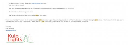

DMX is the standard for moving head lights.Wanted to know if anyone is using a Kulp 16AB for their moving heads. If you are, Are you using the TTY Port
Or DMX to RJ45.
Any assistance, would be greatly appreciated.
Can you give a quick rundown on setting up a moving head on the K8 as far as fpp and xlights setting?Its not as easy as that Mark with the Kulps
I have only been able to get a K8 working with DMX properly but I have to change the model to a F8 with serial (you have to change this in the Expert mode of FPP)
Im no expert on the the full config of a K32 or K16 though
