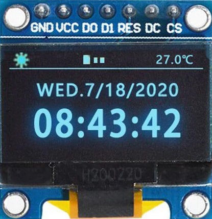

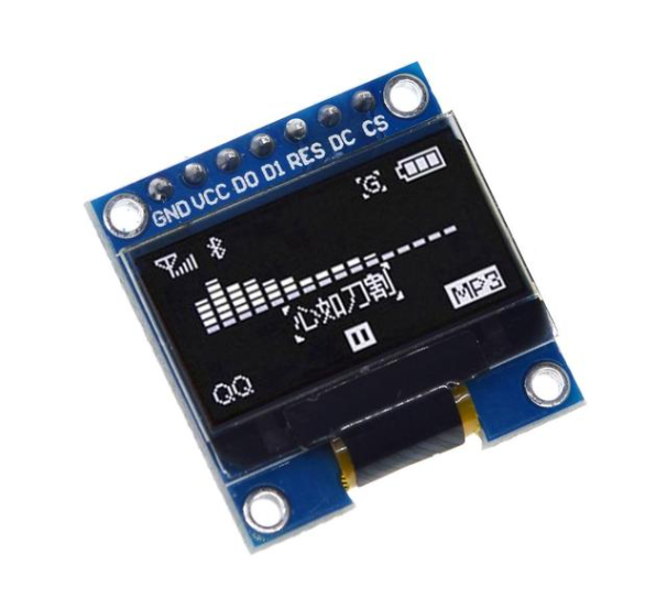

Any will work like BazMick has linked, however, just ensure the pins are in the same order. Some have input power polarity swapped, some are mirror imaged - you may need to use a couple of insulated wire standoffs if the pinout needs changing.
I was wondering if these would work as a replacement for my F16V3 OLED
