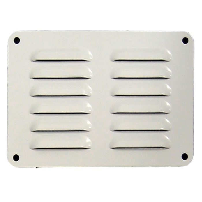

for piece of mind, i added vents to the enclosures and cooling fans
i went a bit over board and used 150x100mm external wall vents , with 120mm fans from a pc
but the boards now sit at 30-40 max in the garage even when its close to 40 degrees outside
so, now i have the cooling fans built onto the enclosure and the fans inside the power supplies .
so, i can say, ventilation and cooling, definatly helps inside enclosures, the difference in temps is astounding

Absolutely agree! Any enclosure I have that get's sun, has a fan/vent and a passive vent.
The Majority of my enclosures are still outside, but out of the sun and under cover. I still use passive vents but not so worried about fans, although if this summer is meant to be as bad as it already feels (was 35° today) I may even put fans in those ones.
