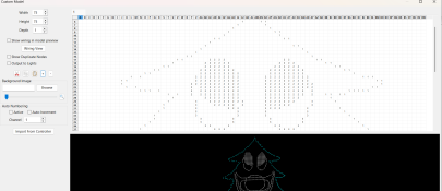

Looking for someone to help: Show is all up and running but I'm trying to migrate to Xlights from another sequencer. Layout has been recreated in Xlights and nearly everything mapped.
One snag I'm running into is I have two mini-light AC singing trees. Model was imported from holidaycoro and it wants to map all 8 channels sequentially from the start channel I gave it. I can not figure out how to set each individual string that makes up the face to it's correct channel number. IE (Eyes Open = 29027, Mouth Top = 29031, etc.)
I've got protocol set to renard, string type set to single color.
If I set the # strings to 8, only option I see is indiv start nodes. No option to specify start channel.
What am I missing?
