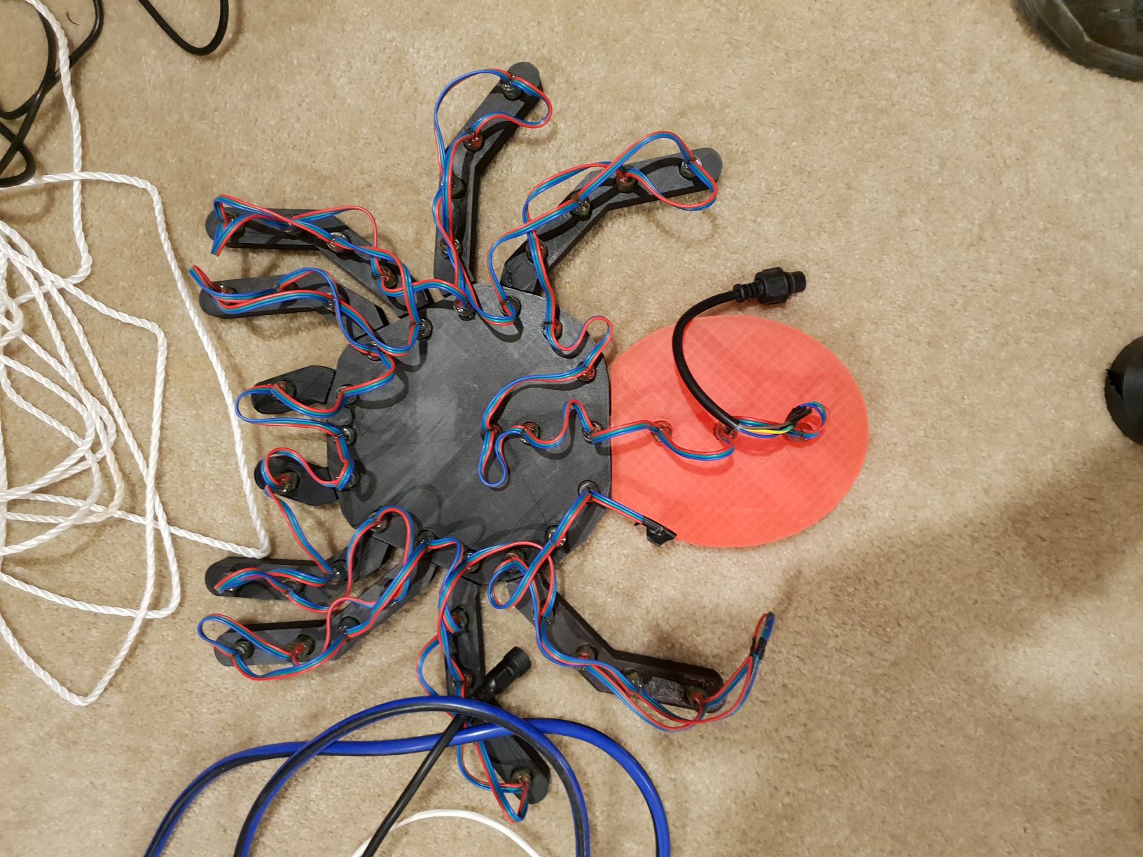

When you printed is the back part see through red filament or just regular? Want to print a few of these for Halloween, should get my printer next week!

Just realised that the abdomen isn't included in the file, could you please share?

Yes the abdomen was printed with transparent red. But I printed one in white (not transparent) and light still glows through it and being white, you can change the abdomen colour with the pixels.

Thanks for your effort was great having this for Halloween, will print a few more for next year. Takes 53 pixels. Took about 24 hours to print all up I reckon, maybe even a bit more.
Looks good. Glad to see someone getting use out of the file. Did you do any submodels for the spider in xlights for the various parts? If not I could share the xlights submodels I used for them.

Below is how I split it, would be great to see yours. Might have wired it slightly differently.
