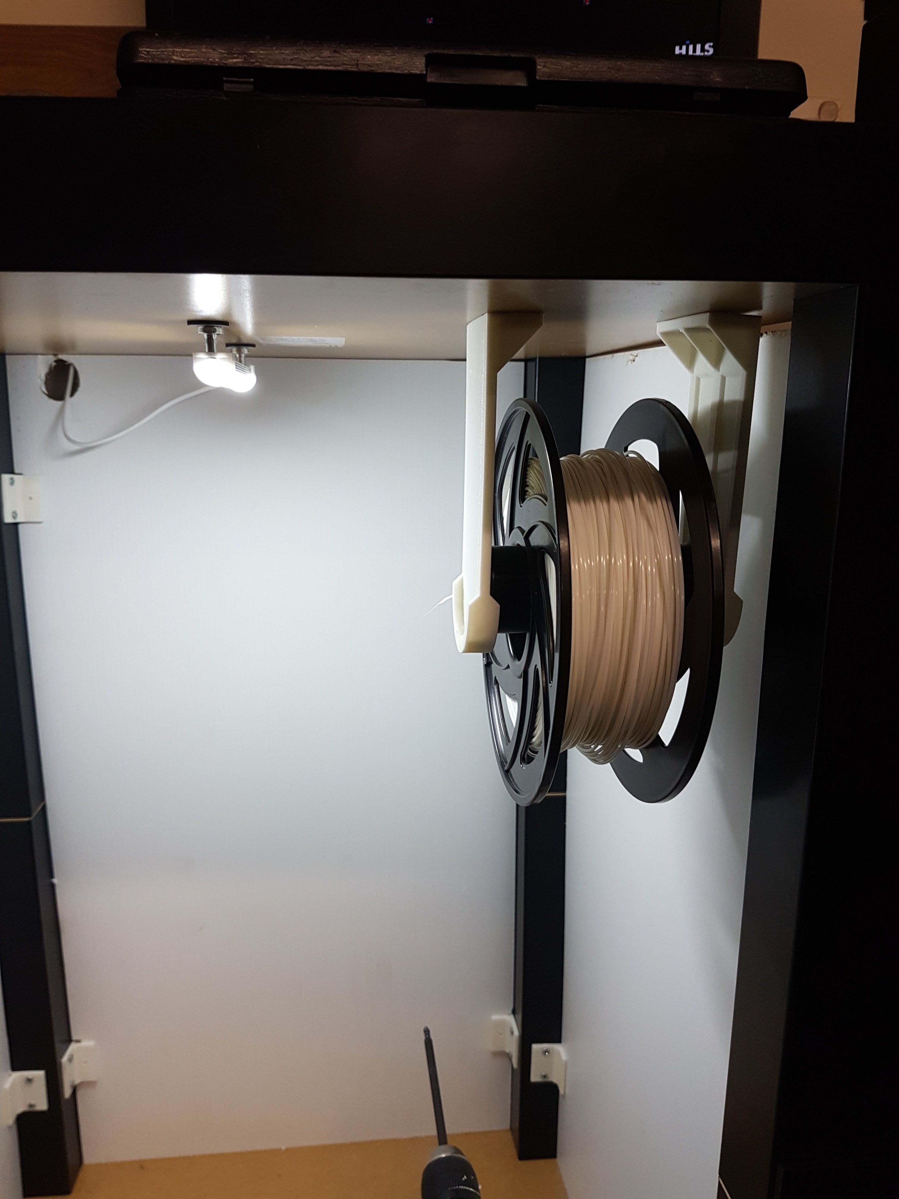

    @lithgowlights the lack tables on your A8... how have you arranged them? I have three, but unsure how to get it right.
    Also what upgrades do you suggest? cheers

    here is how i did mine ready for a A8
    all parts 3d printed. 3 lack tables one on the bottom then 2 leg to leg so plenty of room inside
