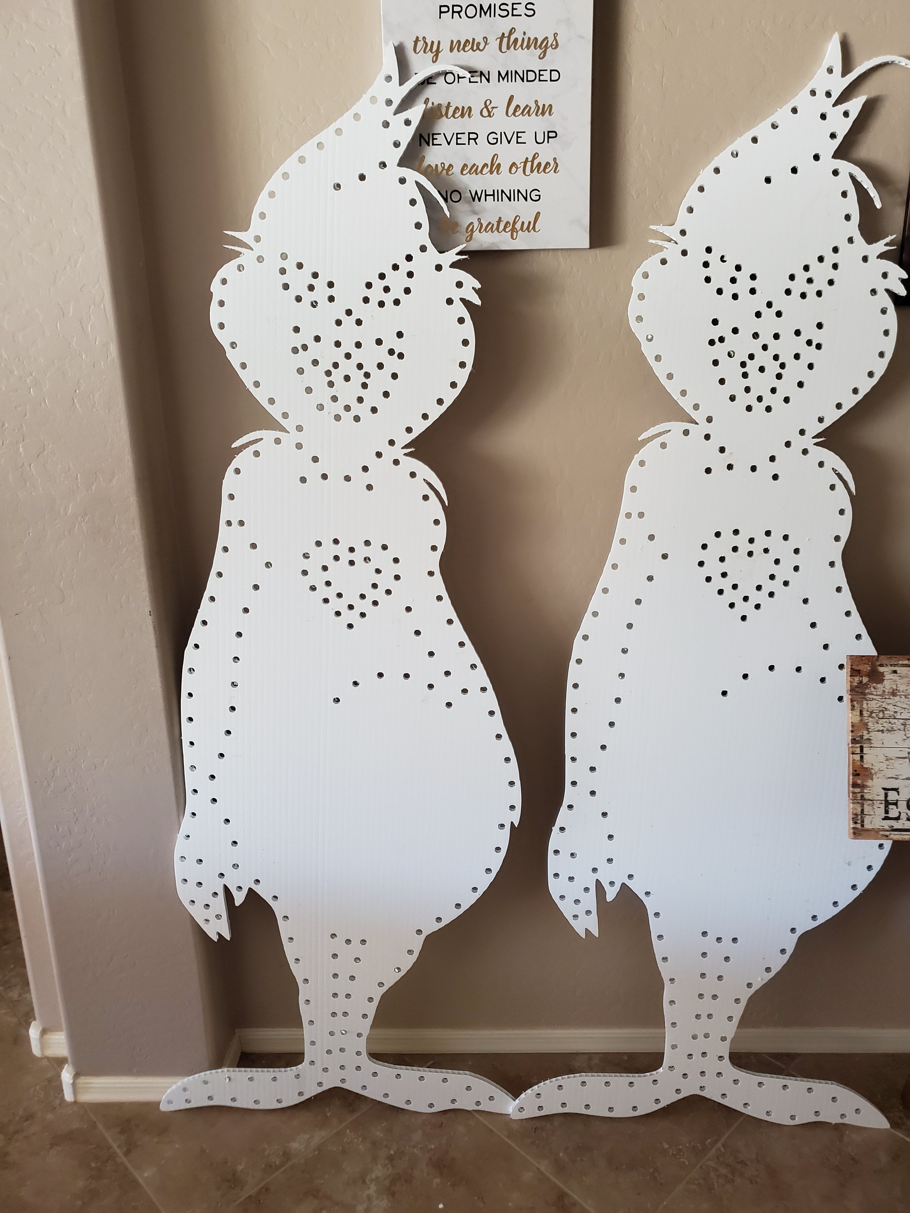

So because of your difficulty in the finer details, I would also start designing in xLights. Get a photo of your house or get someone on fiver to sketch it up for you in 3D (it cost me about $50). Layout your pixels in spacings of either 1, 2 or 3 inches (because that's what most of the pixel strip and pre-made props come in). The whole reason behind this is to that you can "bulk buy" your starting pixels with pre-made lengths, pre-made pigtails, off-the-shelf props etc. and you will minimise the manual making. You will still have to "push" the pixels though - not much you can do to get out of that one! Browse on the Christmas prop websites for items you like, such as trees, arches, etc. It's going to be a tad more expensive to buy everything if you want to start big - it's up to you.

Since earlier this year I decided that new props should go onto pvc frames which I can put up quicker and easier and also swap out between Halloween and Christmas. What might have taken me an hour on a roof is now down to maybe 15 minutes to put up. They come down in under 15 minutes. Pre-planning can help a lot when you go to put things up when you have mobility issues.
When pushing pixels into props I try to pace myself and do so many a day. i found i could push 200 pixels a day without issues. If I do too many my hands become sort of useless for several days afterwards.
