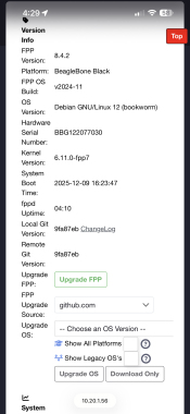

I’m currently using 8.4 by the looks of it. But I’m sure I have used the upgrade at the start of this year to get into the 9 . Somthing firmware. I have attached a screenshot above. Have resigned the cape this morning and still working after a restart but when I go to sign my second key I get an error contacting api. Do you think this would be a SD issue as described above ? IMG_8807.png
It sounds like yet another case of a board being bricked by the FPP licence system breaking. Erasing the eeprom manually has been the only way I've ever got boards back to life.
