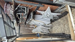

I also have both. I have found the corro props become brittle and quite easy to break after a couple of seasons in the Qld Sun. I think the only vendor in Aus that does the foam board is Johnno from Inc Creations, and his quality is really good. Fortunately I have not dropped any of them (yet) so cant speak to the durability of it, but have dropped quite a few corro props. New, no problem. Couple of season old, break / split.
If you look after your props in the off season, and can store them out of the sun, you should easily get multiple seasons out of them irrespective of using corro or PVC foam board.
