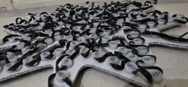

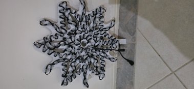

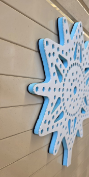

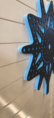

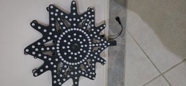

I have laser cut from 15mm XPS foam board sandwiched between 2 x sheets of 3mm corflute (White / Black)
This gives the rigidity from being laminated and light as. Also a prop that offers a choice of Black or white.
