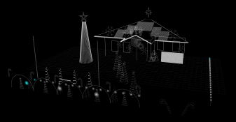

You can also just set up 2D pictures of your house in 3D mode - rotate them to fit the plane of where they are taken from.
It'll look a bit dicky though, so you keep the images dim.
You also don't need an image at all.
My 3D layout has nothing other than the lights on it - and I can clearly understand everything that's going on in it- because of the shape of the house, location of the props etc. The only downfall of not having an actual model is that it's "See through" - I can see lights in the xLights render that are otherwise blocked by parts of the house from a particular angle
Xlights renders (mostly) from a flat 2D perspective, so no matter if you have a detailed 3d model or flat 2d version, it should look about the same.
There's a big difference between 3D mode and 2D mode as far as what you can do when rendering is concerned. Yes, everything is rendered on a 2D plane, and if you always leave the default rendering settings intact, it'll be (mostly) the same.
However, the real power of setting up in 3D mode you have the ability to choose the Perspective/Camera Angle to which the render of the effect is made. That way you can have stuff going front-to-back, with say a top-down camera view. There's no way to do that if you use a flat photo of your house and set up in 2D mode, everything is "Faked" from that single 2D perspective.
