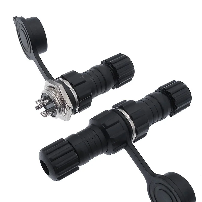

I use this connector (10 pin) version for my Ethernet, the 3 pin would do well in this scenario
