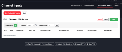

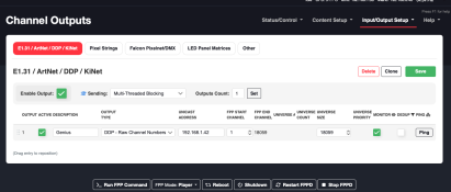

I’m hoping someone can help me troubleshoot a DMX issue.
I’m trying to control a BeamZ Rage 1800 snow machine from a Genius 16 controller running with FPP and xLights.
My pixel outputs are working perfectly, but I can’t get the DMX output to trigger the snow machine.
The setup is:
  • xLights → FPP → Genius 16
  • DMX1 on the Genius
  • Commercial RJ45-to-DMX adapter
  • BeamZ Rage 1800 set to DMX mode
A homemade RJ45-to-DMX adapter worked intermittently, so I replaced it with a commercial adapter. Since then I haven’t been able to get any DMX output, although I’m not sure if I’ve changed something else in the configuration at the same time.

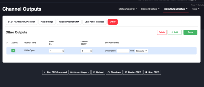

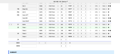

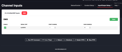

From what I can see:
  • DMX1 is configured on the Genius starting at channel 1 with 8 channels.
  • My xLights DMX model is assigned to Port 1, starting at DMX channel 1.
  • FPP is running as the player and the pixel outputs are working correctly.
Could someone please have a look at my screenshots and let me know if I’ve missed anything in:
  • the Genius configuration,
  • the FPP configuration,
  • the xLights controller/output setup,
  • or if this sounds more like an RJ45-to-DMX adapter pinout issue?
Also, has anyone successfully used a commercial RJ45-to-DMX adapter with a Genius 16, and if so, which one?
Any help would be greatly appreciated!
