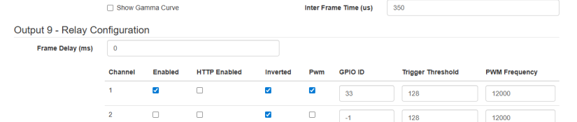

2) My boards have a relay setup to turn on and off the power supply. Running WLED it worked great, but I cannot get the relay to turn on when I start show. I have set output 9 to relay and the GPIO to 33.
I would like the relay to turn on the power supply whe the show starts .
Any suggestions?
Any suggestions?
