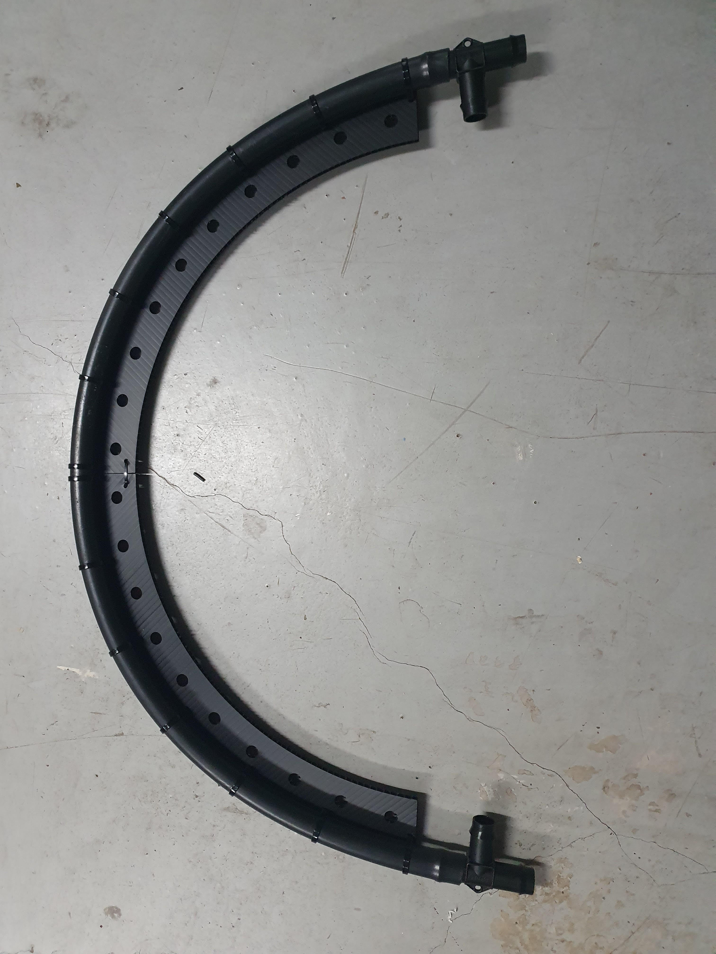

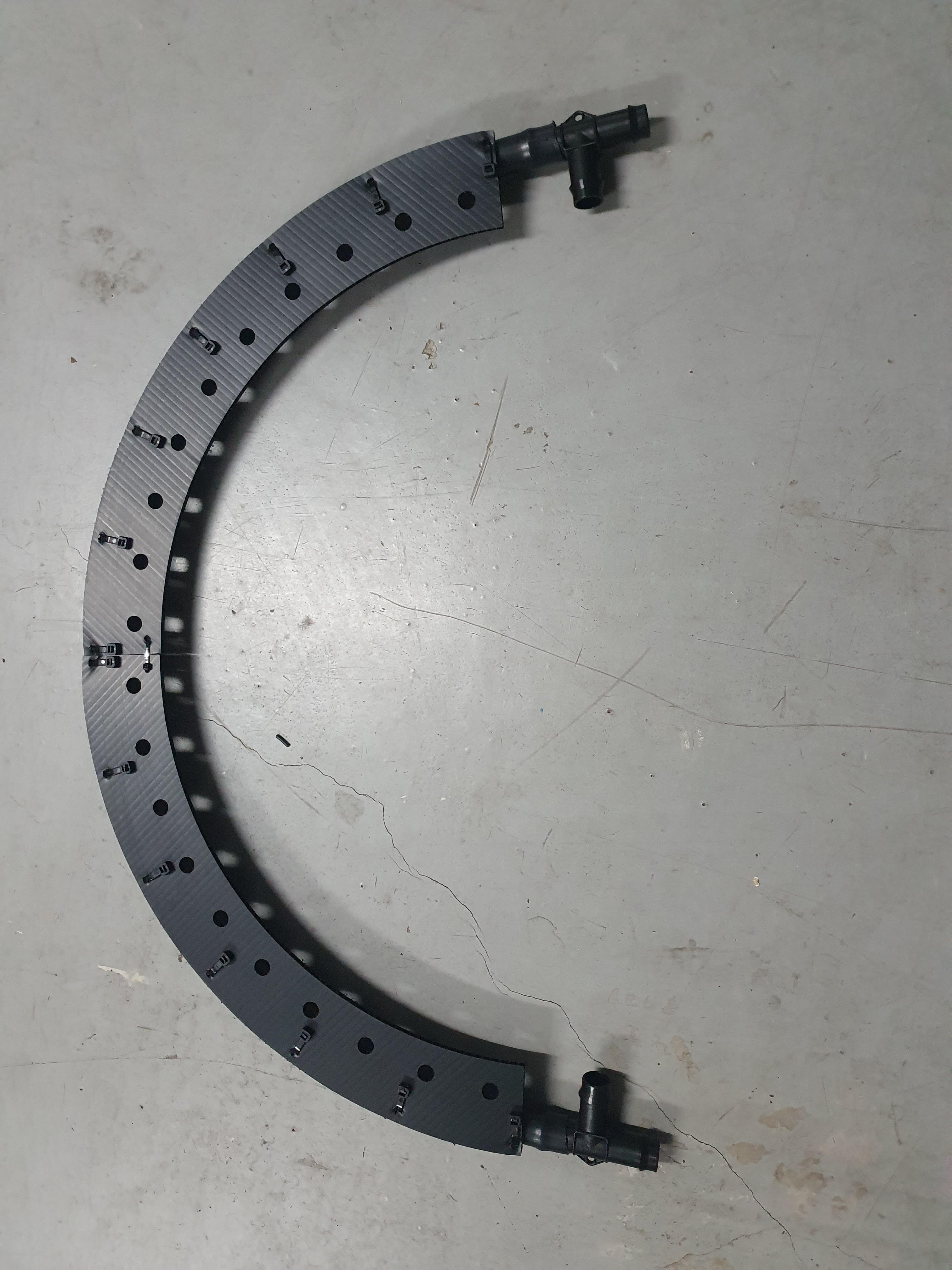

So had a think about the black poly pipe I used to test the small arch and found that it's semi rigid and easier to work with than then 15mm or 20mm pvc. (Mind that I had around 10 meters of poly pipe in the garage that I thought I'd put to good use)
I've got some screenshots of one I setup below just using zip ties to hold it to the pipe as I shape it to the coro.
Also found that the 19mm poly pipe tees can just be inserted at each end of the arch.
Next step is some rebar and and a small clamp to being the two ends into a better shape but also add some weight to the arch.

@JordoLights My poly pipe arches fit into pvc joints then I have pvc pipe running along the base. My base has a length of chromatrim with pixels in it
Think my poly pipe is 25mm diameter, with matching pvc joints and pipe.
Thanks for the advice. Finally built one. I ended up using 19mm poly pipe and tees. Then 25mm conduit for the base. Just heated the conduit so it'll fit nicely over the tees. Do you reckon the pvc needs screws to secure it to the tees?
