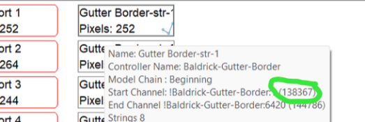

In short - yes - or plug it into any port you already have defined which has at minimum the number of nodes on it that you need for your custom model.
So - if I was doing a model that was 150 pixels long, I could plug into into the first port on this baldrick as it has 252 > 150 nodes defined:

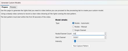

In the custom model generator - you would set the same start channel (138367 in this case) and the number of nodes:
You could also create a single line model of 150 nodes, and put it on a dedicated port (where the prop will end up) - the process is the same, it'll be assigned an xLights channel number, and after you do your controller upload etc, you can use that as the start address.

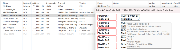

Using my example above - you can see the channels assigned:
The F16v4 starts at channel 167179
The E4S on the driveway starts at channel 175912
If I put in channel 1, it would display on my P6 panel, which consumes the first 124 thousand channels
If it is a clean/unassigned controller - then it will have NO channels assigned. You need to have a prop on it, with the at least the number of channels required.
