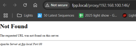

  • Went to Status/Control > Proxy Settings in FPP, clicked the IP link, received error..
"Not Found
The requested URL was not found on this server.
Apache Server at fpp.local Port 80"
I have noticed that differing from the video, the address attempted to be connected to is http://fpp.local/proxy/192.168.100.146/ whereas in the video the it shows the actual local IP of the Pi, I did try this but received the same error (http://192.168.0.132/proxy/192.168.100.146/). I know this shouldn't really matter, but tried anyway.

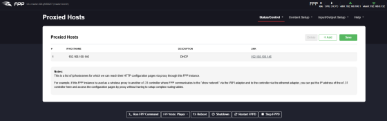

  • I then installed FPP v9 via Pi Imager and went through the same steps and ended up with the same error. (Screenshots attached, was using FPP v9 when taking screenshots)

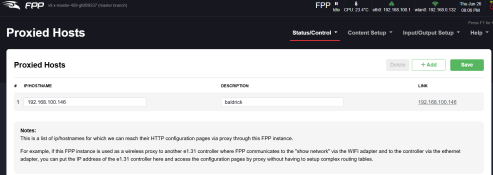

Why is it after posting you always find something that works.. :)
Instead of deleting my post I'll just comment what I did to get it working (for now, tomorrow is another day)
I ended up manually adding the Baldrick as a Proxied Host and can now access it. (why didn't I think of this earlier)
Current setup is Pi and Baldrick connected to switch with their own IP range and accessing Pi over wifi from Laptop.
I understand FPP v9 is still early days and things may change, but this is working for me at the moment.
When you do a Tools -> FPP Connect - I believe there's an option to automatically add any proxies required for that particular FPP instance, which automagically configures the above page..
