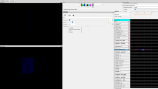

Hi guys, me again. lol
I'm not sure if it's a combination of my efforts or not, but I've had this sequence done for a while and worked fine.
I've just updated to 2026.02 and in the same day I converted all my lights from the orig picture overlay to a 3d Layout, spent over 3 hours measuring etc and making it all accurate.
now i've loaded up a sequence to test and now the matrix isnt previewing properly, Just all scrambled. In this clip, it's just words scrolling across the matrix, but in another sequence, theres a GIF animation and it's also showing the scamble look also.
anyone else having this issue with the new update or is it something else?

I would suggest installing 2026.01 and seeing if you still have matrix issues. It should still accept all the changes you made.
So still having issues with this.
I've gone back to previous version, no fix, latest update just came out, still broken.

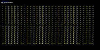

I exported the model back just after I created it, so I imported the model back in and tested it. it works.
but when i right click and "replace a model with this model" (the new one) and choose the orig matrix where all the sequences are applied, it breaks and only shows a single line. ( as seen in second picture)
i've created a new group for the 2 matrix and if i put the effect on just 1 part of it, it works fine, but when applied to the group it breaks again.

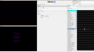

Without knowing anything about 3D layouts on xlights my guess would be that what you're seeing on the house preview is due to looking sideways across the matrix rather than a front view. On the layout tab I'm guessing that there is a rotation for the prop that is out by 90 degrees.
yes maybe? , but still doesnt answer why in the first post it just shows the the full front view scrambling the entire screen.
that's the preview of just a "text" saying "Yeah" and fills only about 20% of the middle of the screen scrolling across. the top and bottom part should be blank, yet it's taking up the entire matrix.. i'm completely confused

In order to potentially work out why effects aren't showing properly will need to see screenshots of the 2 matrix layouts.

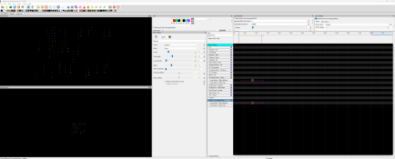

both layouts are the same as the one i attached node wise.
Individually, they work fine, but when the are grouped (in last pic) it just alternates between
, the only thing changed was the effect was moved from individual to the grouped
Video of switching
View: https://imgur.com/4AenfJX

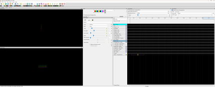

With text. only moved the effect, no changes

Problem solved thanks to AAH,
for people with similar issue,
I had 2 separate Matrices, ended up Creating a new "larger" custom matrix combining the 2 together and configuring as 2 strings.
with starting nodes of 1 and 600, named the same as existing matrix and seems to work!
For those playing along at home and who may want to see if the issue is a bug or a user config issue the settings were as follows
2 Matrices of 600 pixels each on 1 port. The 2 matrices were combined into a group. The 2 matrices were oriented side on if viewing from 2 2D perspective. In 3D it could be turned so that they were face on. When sequencing if anything was placed on 1 of the 2 part matrices the sequencing would be fine. When a similar effect is placed onto the group the results were garbled and processed by what looked to me as if the effects were side on. I created a single matrix which had both halves of the window matrix. Once that was done the effects would work fine. I assumed that the issue may have been coming about as the 2 matrices were in 3D form but groups only have the option for 2D. 3D is above my pay grade so I don't actually know of any limitations.
