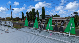

made a similar frame for some props and just put tube back on an angle using delta inspection tees so the props were just off vertical and fall back a little and then added sand bags to hold it down
where i needed the delta tees to go four ways i replace the inspection lid with a 3D printed fourth leg
