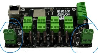

Let's take off the table anything you could do with expensive load sharing PSUs. Then yes, 2 is the limit for attatching to the Baldrick 8. As circled.
In rounded-off numbers, an LRS-350-12 puts out 30A and the board takes 4x7.5=30A. Nicely balanced. 7.5A will run a lot of pixels. And 7.5A is a lot more than pixel wire and standard extensions can take.
