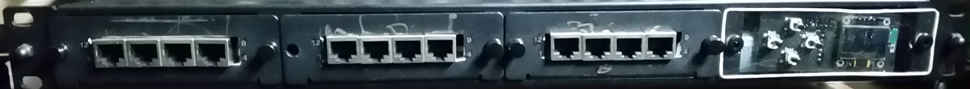

Are the PixelBone compatible FPP or something you dreamed up entirely on your own? You should be able to use one of the other cape models if it is compatible.
Yes @merryoncherry they were my PixelBone 5 Series Controllers. (FPP+Cape) (all being Slaves to the FPP Master)
