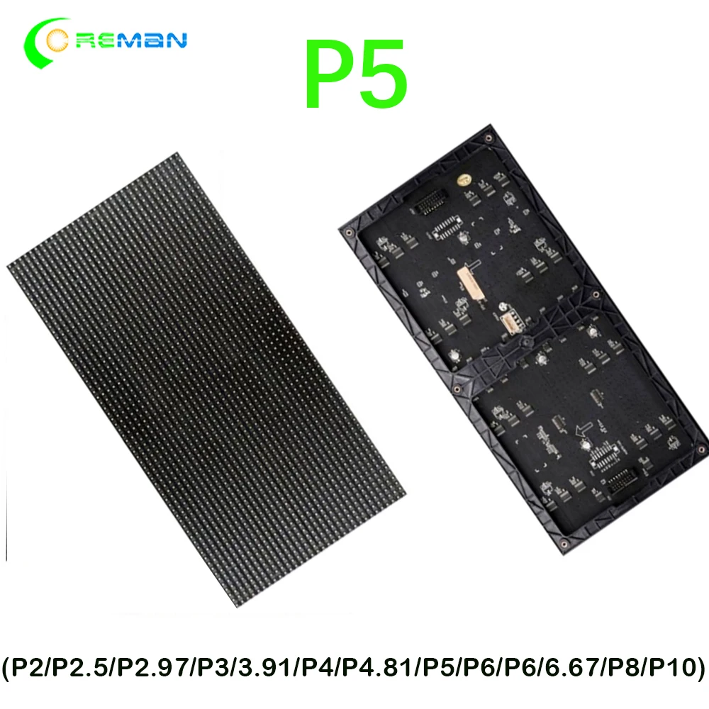

I was looking at this:
64x32 displays P5 led module panel P5 LED Matrix Module Indoor RGB Full Color LED Display Screen, 1/16 Scan, Pixel Pitch 5mm - AliExpress 502
Smarter Shopping, Better Living! Aliexpress.comwww.aliexpress.com
I think I am going to buy 4 panels and see if I even like working with panels. I am still not entirely convinced that I like the looks. There comes this point where you have to wonder do I want to build lo-res televisions or do Xmas lights...
