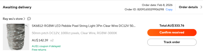

Hope some can help. Bought seed pixels from Ray Wu. Cannot work out why colour of seeds is washed out.
Have bought these previously without any issue.
Roll on right is original purchase. Left roll is latest purchase.
In photos , both rolls attached to same 350W power supply.
Have I ordered the wrong type ?

Thanks, looks like i have ordered the wrong item. i have basic setut and all my other items are 3 channel
