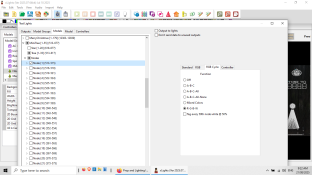

Go into Tools>Test>Models in Xlights and test things progressively to see if your wiring actually matches Xlights.
Test Node1, Node 480, Node 20, 21, 40,41 etc to see if there is an issue there.
If you don't see an issue there then can you post screenshots of the prop setup in xlights, the controller page, the visualiser and also the prop in FPP.
