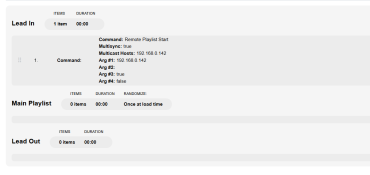

so i thought have the side yard as a seperate player with only the full brightness and reduced brightness as a sequence option so all i have to do from the main player is start my playlist and ensure every start of a song, sends a remote command to the other player and the finish sends another
this way it will multicast a command to a dedicated Host - IE run playlist 50% Brightness
then when finished - it leads out with another multicast command to play playlist 100% brightness
so, FPP is amazing
this way all i have to do for any playlist is either add the lead in and lead out commands so it tells the side yard to either be full brightness or lower brightness whilst a song runs via a schedueled playlist

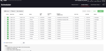

just added the remote start stop to a selection of playlists that each have only 1 diffirent song
Testing so far proves i can make the secondary player run the 50% brightness sequence whilst the song plays, and when it finishes, set the secondary player to the 100% brightness sequence - and force the main player back to the static sequence until the next song event
been working flawless all night in continued testing
