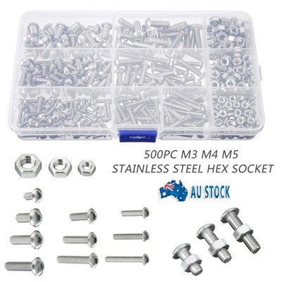

I bought this set for my 3d printers a few years ago and it's come out handy for my box builds. I need to order a new one now.
