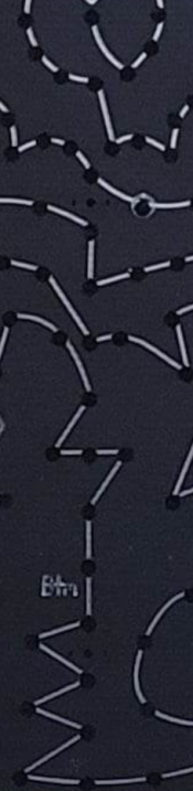

My prop does not have the path printed as it was sourced from the UK, however I did download this pic and have followed it together with the xlights diagram

Surely there is some fiddly difference with the wire path vs the model... I would check the start+end+string joints carefully against the marked nodes on the wire path above and make sure they are correct at the 100 boundaries (it's marked every 50) at least.
Unfortunately my prop does not have a printed path so I am to some extent working blind
When powered up all of the rings are lit fine but when I try the spokes as it were there are two or three out of line , I have checked these in X lights and they do light up as they are supposed to I.e. no 34 is 34 on the string, but they are completely out of place on the prop and the actual lit ones will not reach the desired hole to complete the spoke
It is almost as though the sub models have incorrect string numbers , however I doubt that is the case
