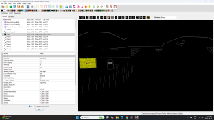

Mmm, I see where your going with the RGB thing, mine are correct, as for brightness I have my matrix at 30% Any brighter the USS would probably think I was signaling them.Screenshot (3).png
Matrix in layout tab show's purple, just like the Boscoyo models. That's why I'm thinking I have the model part correct. Also you can see the starts for the different strings. I never had that until I followed your steps to get custom.

Welllll, there can be more than one kind of problem. I wonder if you rerendered and saved, but the other thing that jumps out is that the channel numbers don't go up by 1500 from one port to the next, most are 1500 but there's a 2x1499 and a 1502 ... Hit that upload button one more time too. Or something. It doesn't really explain it IMO unless it does explain it. This is set to DDP, correct?
The other thing that might find problems quickly is to do a "check sequence" (with no sequence open, actually, it still works and is more of a "check layout", which is what we want).
I'm checking the math on the channels now. Yes, it's DDP. I'll also do a check sequence. I'll let you know. Thanks for your effort.
Yea, I pretty much render and save ad nauseam since you last mentioned it. My math is showing 1499 down the board. Should that be corrected in the controller screen, and if so, how??? 1499 is based on 500 x 3 for RGB. Obviously it should be 1500. So why is it not? Is that due to un-even amounts? 500 vs 1000 pixels? Numbering is correct in the x-lights layout tab though.

Start channels and end channels are inclusive... so a single pixel might be channel 3-3. 500 pixels (1500 channels) may be 1-1500, 1501-3000, etc. But your one screen shot is showing irregularity on that. Matrix-str-4 should start at 10264...
