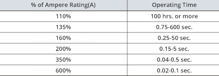

The current for 2 P5 panels is potentially over the 7.5A rating of the fuses depending on the panel brightness. If there is a gradual buildup of heat then the fuse trip current will decrease. For a 30 degree temperature rise there will be a drop in the capacity of about 5%. If you're running at higher than the rated current of the fuse then the trip curve also comes into play.
