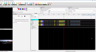

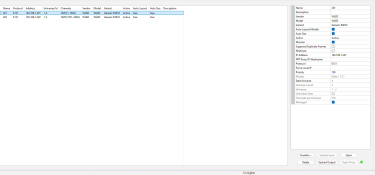

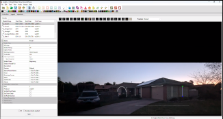

Below are screenshots of my settings if that helps. Have also attached a section of the Log files from xScheduler that do show some errors, but not sure what they mean or if relevant.
Controllers in xLights
Layout
Sequence
