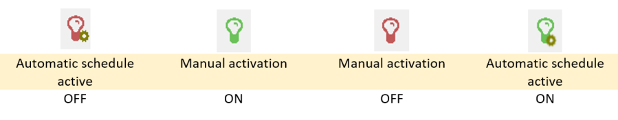

Also make sure your output lightbulb is set to show a gear (for automatic mode).
clicking through my bulb if I set it to automatic schedule active on it then changes it set to off. is this becuase it is currently not in its run time?

Light bulb will change between green & red as the schedule activates. It should keep the gear the whole time for schedule control active.

I have just tested it out with the little gear icon on the bulb at it appears to have started automatically so I think that my have been where I was going wrong despite searching I never managed to find info about that icon. I'll check again at 10:45 haha.
