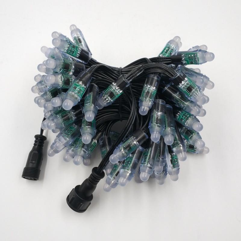

The first thing to come to mind is to use premade small bundles of pixels for peace stakes. they have pigtails on both ends and you can keep chaining them together. The nice thing is that with 5 pixels per bundle you can do some different things with them besides a simple color if you eventually want to do that.
I've actually bought these and have ten of the 5 pixel bundles chained together with five of the 13 pixel bundles. Here is a link to the test I did of the peace stake bundles. My skills are poor but it was just to test everything together.

My thinking here is that 12V modules would be a better option than 12V nodes. The modules typically have three LEDs connected in series to use the 12V more efficiently. The nodes waste the extra voltage and power with resistors or a regulator. In other words, you can expect a 12V module to produce three times more light than a 12V node for the power that it consumes. You may as well maximise your light output per power supply.
From the initial post here, I don't know whether computer control is required. If so, I would suggest something like this: https://www.aliexpress.com/item/326...store_pc_allProduct.8148356.61.859f2316eBFgXz
This option needs the controller (e.g. a Falcon F16v4) and software (e.g. xLights). The choice of controller depends on your specific requirements and future plans.
If these are just going to be steady on, I would suggest using single colour or dumb RGB modules that otherwise look similar to those in the link above. I'd grab a link but AliExpress is no longer cooperating. I'll try again soon and post a link if I can get one. These would be simple to set up once you have the wiring done - just provide DC power and they'll turn on. No software or controller is required unless you want to switch or fade them on and off independently from the power source. Dumb RGB would allow you to choose a colour by independently connecting the red, green and/or blue to power but it will stay that colour unless you get a dumb controller. I question the feasibility of this controller type in the pictured setup due to the excessive amount of cables that would be required to implement it.
Regardless of the type of module, you'll also need to choose some cable to run between the pumpkins and/or supply the power to them. Shorter and thicker runs of cable mean less voltage drop. Thicker wire on the modules themselves is a good idea but as long as it handles the current, it should be okay. The reason that this is less critical is because the wire attached to the modules is a short length and voltage drop happens over distances.

If I wanted to go with using the coro pucks and use 5 pixels in each pumpkin, how would I go about getting the 5 pixels for each pumpkin? Would I buy a strand of pixels and cut them up and solder on connectors at each end? That's the part I wasn't sure about. When it comes to the controller and xlights I'm good there. I just wasn't sure how to "break" up the lights for each pumpkin and connect them in between each one and then get them back to the controller.
Thanks again!
i13
Dedicated elf
Jul 5, 2013
1,172
You can do that however you want to. You can cut up a strand of pixels and solder connectors or longer lengths of wire between them. Some pixel sellers will do this for you if you ask for it. There is a limit to the length of cable that you can have from one pixel to the next before the signal goes corrupt between the two pixels. Looking at the picture of the pumpkins, I don't think you'll reach this limit if you daisy chain the signal between neighbouring pumpkins. There is no limit to the total length of cable in a run of pixels as long as no two adjacent pixels are too far apart. You also can't exceed the maximum number of end-to-end pixels supported on one controller output.
