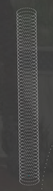

i have started creating some seed pixel poles utilizing the SFL 4 inch tree topper as bottoms and top bases
i have designed them in xlights, and whilst i wait for the toppers to print so i can start prototyping,
does anyone know some good effects to use on a 360 degree pole ?
i want to test effects in xlights

Is it a tree model? First thought is the same thing you;'d do with a 360 degree tree or a matrix. Have been doing this with the tree out front that has a net wrapped around, same shape.
should i look at some of the more exotic things they do with mega trees for these poles ? there only 4 inches round , 60 pixel high (5cm spacing) 3m tall
I would say they work like mini trees, column matrix, pixel pole, mega tree... all of those things flatten out to a matrix that is tall and skinny, so the same effects are suitable.
OK Cool, so any effects you know of that look amazing on them ? im just trialing some effects to see what looks best on them for now
Many vendors map spiral trees; those effects would be nice. Single line effects give the spinning/spiralling effect, with different colours etc you can get some pretty cool looking things happening.

Some effects for a spiral cylinder that I can think:
  • Single line: Spiral up/down/centre-out/centre-in, bounce up/down.
  • Pinwheel rendered top-down: gives an affect like vertical bars rotating around.
  • Bars with spiral wraps: Like a candy cane spiral stripe rotating around.
  • Guitar effect and use each strand for a guitar/bass guitar. Use MIDI tracks for best effect.
  • VU meter and grow/shrink from the bottom, use for beats.
  • Wave Effect, may need to create a 2D matrix shadow model.

Create a matrix the same height and width as your tree - so if you're spiraled 20 turns at 15 pixels a turn, make a 300 node matrix, 20 high and 15 high.
Set the start channel of the matrix to anchor to the start channel of the tree.
Then render the effect on the matrix. It'll map onto the tree, channel by channel.
