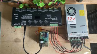

Wiring to the DMX is one channel per color/section based on the current switched wiring. I didn't need to repeat that process 16 times in the picture below. (DMX Channels are arbitrary in the image until I actually wire them to the decoder depending on their system.)
I'm hoping this design is correct. Again, Spymaster, thank you.
Also, I want to thank ryanchristmaslights for getting me authorized on this site. There was an issue with my email service and he took care of it.
Thank you, Sir.

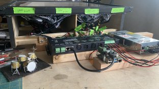

UPDATE:
I tried the ENTTEC DMX Open USB and did not get it to work with the Pi. It works as I tested it with my laptop directly. That's fine. I spent a couple days trying to get it to work and sometimes those lessons in patience are important. I keep telling myself this.
As soon as I connected the ethernet and made a couple changes in FPP and xLights, it worked. Thanks for the assistance, Skymaster.
