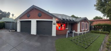

Managed to get my lights lit up for 1st Dec some how - was doing the final touches last night at 7:20 for a 7:30 show start!
Will do a more indepth post but now have:
3 Baldrick8 Controllers
just under 8000 Pixels
P5 panel display 6x8 panels 384x256 pixels ~1900x1200mm
New props: Flakes, Canes, Pixel Field, 3m Mega tree, Vertical/Horiz outlines, 10w floods.
Mix of evo and seed pixels from raywu
Just waiting on my XLS450 flake to turn up from @Christmas Props Aus.
(ordered bit late but thought i might have had it just on time but hopefully this week)

I need to think about how to attach them to ceramic tiles... I'd like them to be removable too.
you could have some kind of thin metal/maybe 3d printed bracket that you could slot under/between the tiles
Ah of course - that's an excellent idea. I am mainly thinking along the peak of the roof lines but could 3D print or bend wire to fold down under the next tile tier. Cheers for the thought.
